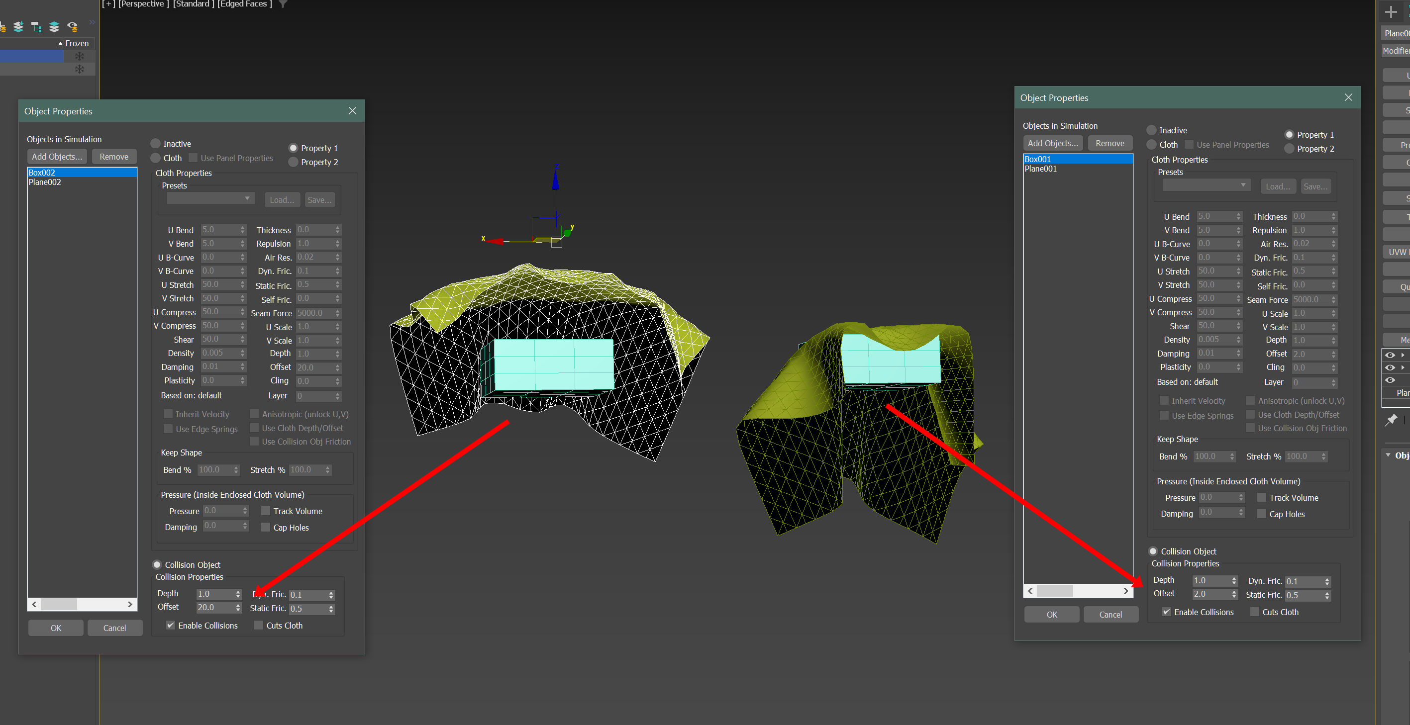

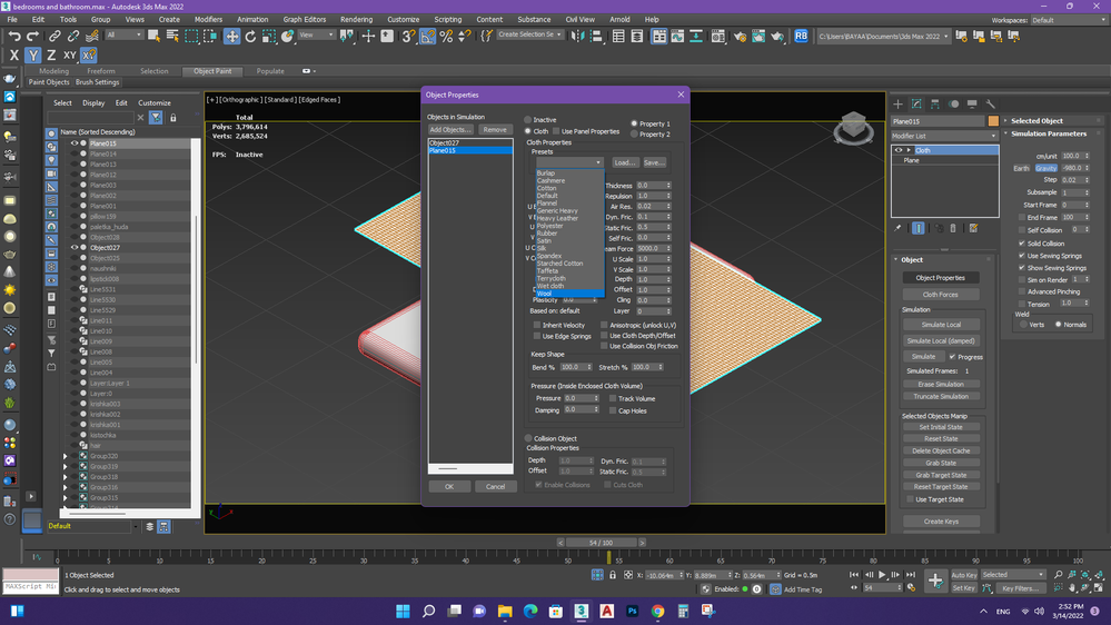

when I use the cloth modifier it doesn't work probably with me, always there is something wrong mainly in positions, I feel like it didn't read the colliding object true scale and dimensions or whatever, I don't know but I searched for a solution and I didn't actually find someone with my problem so I thought about posting it here , maybe someone can help me.
here is some screenshots of the process
thanks in advance

Try playing with the 'Offset' parameter of the 'Collision Object' for your stationary object. It defines the invisible space around that object.
