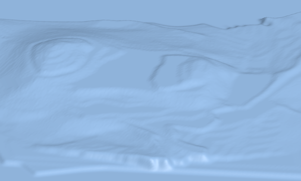

I'm looking a way to make a mesh from the average of the slices you see on the following image.
What I've done so far is a displacement modifier with a height map extracted from the z-depth channel.
The problem is that, even after blurring it in photoshop, I get all sorts of artifacts and it doesn't look soft enough. The resulting mesh is shown on the second image.
I was thinking maybe a cloth modifier that can fall and take the shape?
Thanks!
(Disregard the difference in color please)

Turbosmooth would be the same as applying a blur in photoshop. I was hoping to find a way of keeping the detail where the lines are closer together.

Since you have the contour splines (or if you have a mesh at the moment, can extract them by Create Shape on the border of the mesh), you can use the Terrain Object to make an interpolated terrain out of them. The resulting triangulated mesh might be hard to work with, so collapsing it a using the free Populate Terrain script to make a grid mesh out of it might be a good idea (plus a Relax modifier if there are still some issues).

What Kris said is exactly what happens when using displacement.
To avoid the problem of rasterized images, I was wondering if there was a better way to do it.
In Rhino you can easily use the lines, plus a cross section or 2 (Nurbs).
With 3ds max, as Swordslayer said, I could use Terrain. But the quality I get doesn't seem to be as good.
Bob, using turbosmooth on the mesh done with displacement is one possible way, but, because it smooths out all the mesh evenly, I do loose some valuable small details (like crests in thin borders, like in a lake). I don't see how you can control the pinch with turbosmooth.
Please see below the comparison between terrain and displacement. I'd choose displacement, but it does have the steps that come with a raster image.

Not really flawless, you'd have to build a connections of those lines yourself first, and the connections would be what controls the slope. So you'd have to draw them in a contionuous manner to be able to reset their tangents. That would take a LOT of time, this is not really a good usecase for Surface.
NURBS are okayish for parts where there's only one 'profile', as soon as a hill splits to two 'peaks', you're screwed.
I posted it before, I'd use what Terrain spits out and use Populate:Terrain or Instant meshes so that you get a mesh that you can relax a bit and/or turbosmooth. Of course, if you really want a good terrain approximation, you'd have to use a specialized software, AutoCAD has a slightly better terrain from curves (with a bounding volume) implementation, and then there are specialized geodetic packages...

Once again Rhino came to the rescue.
The patch command did it perfectly.
I'm still trying to use Populate Terrain, but it takes forever to process.

I ended up using the mesh that Populate:Terrain spit out.
It took about 30 min to an hour to convert the original mesh, but the result was better than Rhino.
The problem with Rhino is that I was getting to a 255 limit in subdivisions.
