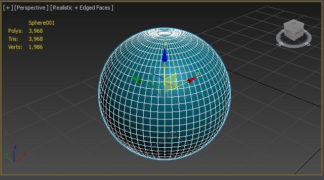

i am creating a audi r8 as usual i am using symmetry modifier but while doing so symmetry is adding polygons too.
in half portion i have a 90k polycount so if i use symmetry it should simply go towards 180k to 200k supposedly but my polycount is going 900karound 1o times the original.i am using 3ds max 2015.

Hi. There are few things to keep in mind when using Viewport Statistics. "Poly" count stat in 3dsmax doesn't count hidden edges when working with Editable Poly objects. For example, if you had a quad-poly object, the Poly count stat would read 1 Poly when in fact there are 2 tri-polys (or Faces). If your Audi objects are composed of Editable Poly objects with mostly quads, then the actual Poly count would be about double your 90k. And in your second image, you seem to have Turbosmooth on. That will quadruple your mesh's actual poly count if using quad-polys, or triple if you have tri-polys. Applying Turbosmooth will give you the actual poly count whereas applying Meshmooth will not. If you need "real" poly count stats, then I recommend turning on "Triangle Count" from Viewport Config's Statistic panel.
See examples attached.

Yes. Turning on NURMS is the same as applying Turbosmooth modifier. But as I have written previously, use the Triangle count as your reference. Poly count will ignore hidden edges in polys other than triangles. I've attached another example of a 5-sided polygon converted to Editable Poly. Notice the difference between Poly and Tri count. If you click Edit Tri in Edit Edges rollout in Sub-Obj Edges mode, you should be able to view the hidden edges, which are in fact edges of triangle polygons.
