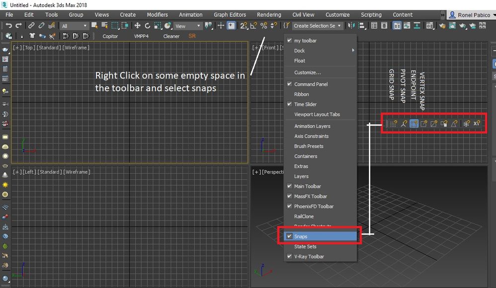

Hi, I did use "snaps toggle" a lot of times, but now Im having some trouble and to be honest I have no idea why or what I could touch that made this happen.
Moving to the point, I ussualy use it for vertex, like Im doing right now...
The thing is ussually before I was taking one vertex with the option activated and dragging that vertex into another one of other object made the vertex to share exactly the same place...
Now... however it seems to work more in the line with "align" as it seem like if some plalne would be locked or simmilar...
I upload a screenshot to show exactly what I see...
As you would see I expect such vertex to move to the other one (moving all the object) but instead it works different... any tip or can you imagine what could be the problem? I did experienced this problem some other times.. but seem to be random or any sort of keybinding I did activate/deactivated by mistake.

when using snaps toggle, you need also to activate which part of the object to snap... check your snaps settings

Its not that... Im guessing this is exactlly the same you get if you right click on the snap toggllle button and activate one or more options...
While the screenshot was taken, only vertex was activated... as I did always (having and not having this problem)
It's because you've activated Axis Constraints mode (ALT+D). Please RMB on the Snap button to show "Grid and Snap settings". Next go to "Options" tab and disable "Enable axis constraints" on the very bottom.
bioclone_ax45
thank you so much! was exactly that.
