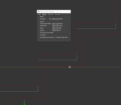

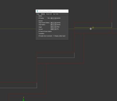

jon79info
version 2022
Working : Snapping of Slice Plane to edges and corners of non-selected polygons of Editable Poly
Not Working: Snapping of Slice Plane to edges and corners of Selected Polygons of Editable Poly.
Can anyone help or confirm the existence of such problem? It renders basic Snap function useless in most cases for me
snap not working 1.jpgsnap not working 2.jpgsnap working 1.jpgsnap working 2.jpg
Message 9 of 9
oliver
I can confirm. Does not work on selected polygon's vertices either.
