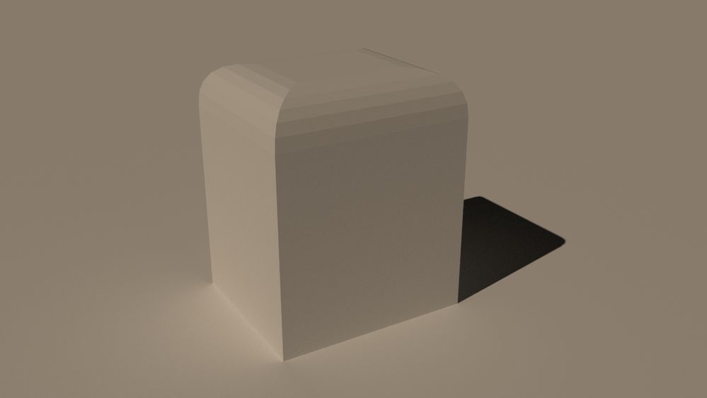

I'm trying to chamfer only the top four edges of a box but the smoothing gets all messed up. Please help!Untitled.jpg

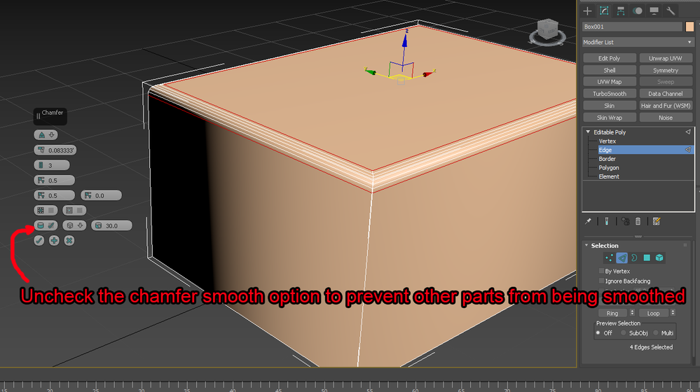

The smoothing group issue you have is most likely due to you a checkbox smoothing option when applying chamfer (see below)
If you want to correct the situation after the fact, it is very easy to do.  Just go into polygon subobject mode select the sides of the box and in the Polygon smoothing Groups section of the editable poly rollout click on clear all.

@10DSpace Thank you for your reply. I did some tests and I'm still not getting what I am looking for. I want it to look smooth but the smoothing is all messed up. See resulting renderings. Your help is greatly appreciated.001.jpg002.jpg003.jpg
Jorge.Sanchez
I cleared all and then applied the Auto Smooth at 18 and got it to partially work, but still not there...
