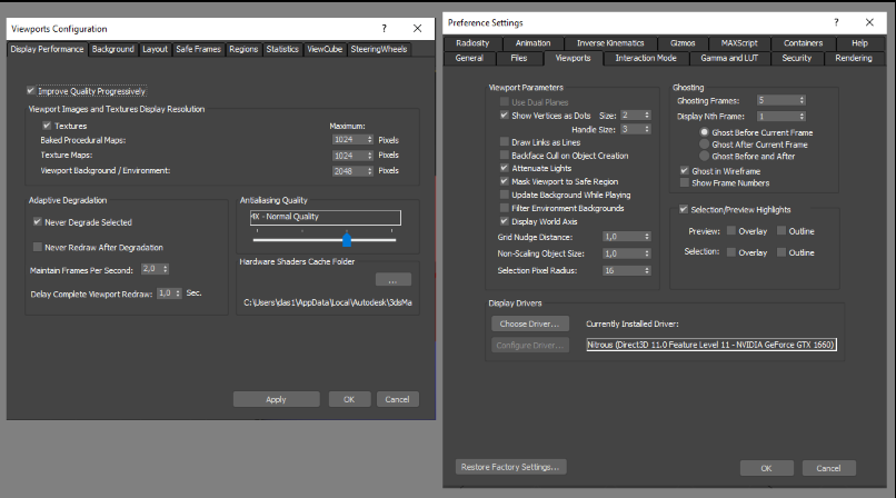

Hello I have a high-polygonal object in the scene, when I turn on edged faces, I can not work comfortably, working with low-polygonal object,
is it possible to turn on the display of edges only selected object, I have not found in the settings will be glad to hear a hint!

not possible... try to isolate your object instead

Of course you can...
Display Selected With Edges Faces (Toggle)
Can find it in view preference also
Was default style or preference for years, changed without valid reason.
And, of course in help doc. still is written:
"In shaded views, by default selected objects appear with edged faces."
mezimforte79
Could you tell me more about where it is located I looked through the settings but there is no such item Screenshot_3.png

mezimforte79
Thank you so much I am very happy for your support
