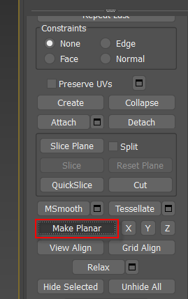

Hello @Anonymous,
I'd like to help with your normal/shading issue in the viewport.  @blakestone has some good ideas about this in his post, and I wanted to offer 1 or 2 more possible solutions.  (Smoothing groups is a good bet, kudos to @blakestone)
If you select the faces of your model and press the button below, does it seem to fix the issue?  If not, it may be due to topology.
Typically we want to keep topology (edge flow) in quads or lower.  You don't need to do that until the end really, but having 5+ sided polygons can often create some weird shading artifacts in the viewport, often due to smoothing groups or vertex placement and edge overlapping.  Please keep me posted!

I'm sorry I have been away for a few days. But yes with your suggestion i fixed my problem. Thanks alot.
