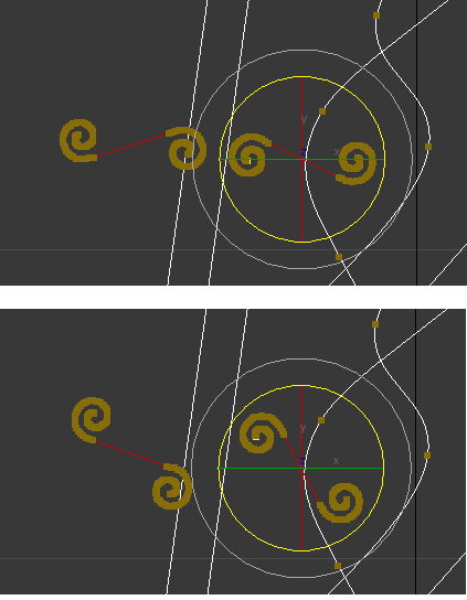

since it's 2 splines, by default when i rotate them, they each rotate around their own pivot.
how do i have them rotate around a common pivot ?
Message 7 of 13
Steve_Curley
I don't mean to be rude, but you really must learn, very quickly, to use the Help. All these questions relate to basic Max functionality which is all described there. You also need to read the Getting Started section, and do the tutorials (on the Help menu) especially reading the Introduction section - to give you a grounding in the basics.
As for rotating around a common point, it depends on where that common point is. If there's a vertex (or a Pivot Point) there then turn Snaps on (selecting the required type), select your sub-splines, click the Gizmo axis you want to rotate around, move the cursor over the required item (eg. vertex) click&hold&drag and the selected splines will rotate about that point. There are other ways as well, like the Working Pivot if there's no other geometry available. You can also rotate about the Selection Center or the Coordinate System Center (the button next to "View" on the main toolbar, not the menu).

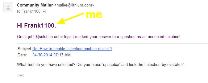

there a bug in the Area forum app ? when i accept someones reply as a solution, then it e-mails me to my name a hurray i've been accepted as solution ??
I re-checked, no accident there where i clicked own posts.
Message 12 of 13
Steve_Curley
Sure looks buggy to me. I'll report this internally.
Did the same happen when you accepted my solution in this thread (that notification is for a different thread)? I don't recall seeing a notification for that when I should have done.

Message 13 of 13
philip.s
Thanks for passing this along and I wanted to confirm that it has been logged as a defect with our dev team.
