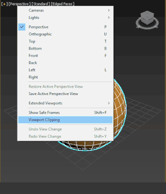

ads_czechoj
ViewportClippingViewportClipping
You have two options (on .gif):
1. Use the Viewport Clipping
2. Hide selected sub-object
Message 9 of 9
