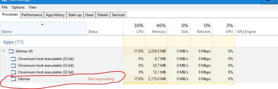

hi,
When 3ds Max was doing, there was loading every 5 minutes. It took more than 1 minute, and then it was reloading. Does anyone know what the problem is?

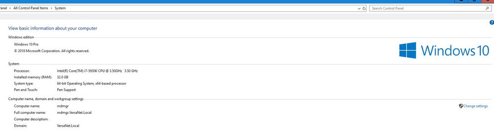

brentscannell
Hi @Anonymous
We're here to help, but I feel like your post is missing a bit of detail about what is happening exactly or how you think it might be related to your system specifications. Can you elaborate a bit more on the symptoms, please?

hi, My scene is also very small, just very common [Polys: 1,378,265]. It is a question of repeating a loading only after two attempts, and then stopping the loading only after two attempts (:
you can see below
http://recordit.co/zL3YEpEHiW
thanks.

Hi, do you think this is my computer's graphic card problem? But the processor also not responding. Actually what the main problem? or 3ds max own issue? My work can't be smooth due to this loading frequently 2-3 minutes per time.
thanks.

Message 10 of 11
brentscannell
Hi @Anonymous
I assume that you are talking about the issue that occurs at about ~ 1:10 in your video? It looks to me like an issue with Autosave and not your video card. Can you try disabling Auto backup temporarily to see if this resolves the issue? You can find the option in Customize Menu->Preferences->Files tab, uncheck "Enable" in he the Auto Backup section.
Message 11 of 11
hi, It should be your problem. Anyway, I will test it for a few days
