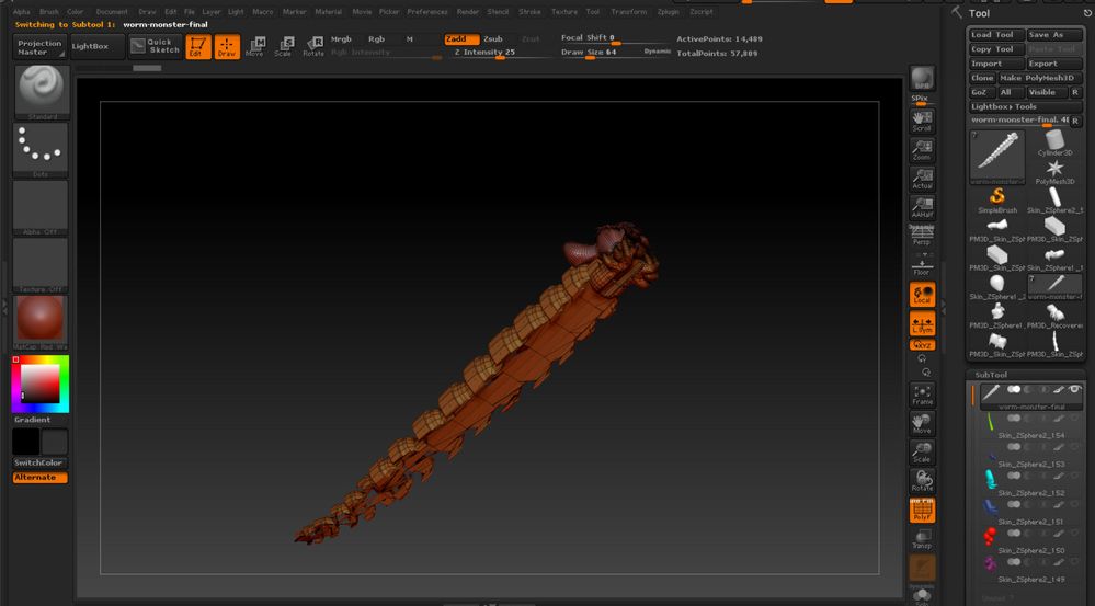

This is a screenshot of the model
this is a screenshot of the model in zbrush
10DSpace
@Anonymous
I see the holes in the tail with geometry that is all messed up in your Zbrush screenshot.  Did you try to weld the vertices of the Tail in Max before export as I suggested above?   If the mesh in Max has unwelded vertices then there will be gaps (holes) in the mesh when you subdivide in Zbrush.  Also, in Zbrush there is a WeldPoints button in Geometry>Modify Topology>WeldPoints which will weld vertices (only works on a mesh without subdivisions in Zbrush, so you have to do it when you first import it).
I ended up trying all of these solutions you mentioned in both ZBrush and 3DS Max (the weld options in both applications) None worked in the end; although, the solution I discovered for filling the holes in the end took place in the export selected dialogue box that pops up upon after clicking FILE>Export Selected in 3DS Max. Instead of choosing Quads, I chose triangulation too, which ended up filling the holes in ZBrush when ZBrush asks you if you want both triangles and quads. Triangulation is by no means a pleasant thing, especially when doing work in an application like ZBrush. But, at least those holes at the bottom part of the worm were filled upon after selecting "Quads&triangles" when importing the .obj.
It gave me a clear answer that the topology was just no good and I learned my lesson that by just doing simple base meshes without any sophisticated modifications, you avoid the risks of getting holes between these two applications. Thanks anyway for your help and I've included what you've recommended me doing in my notes.
