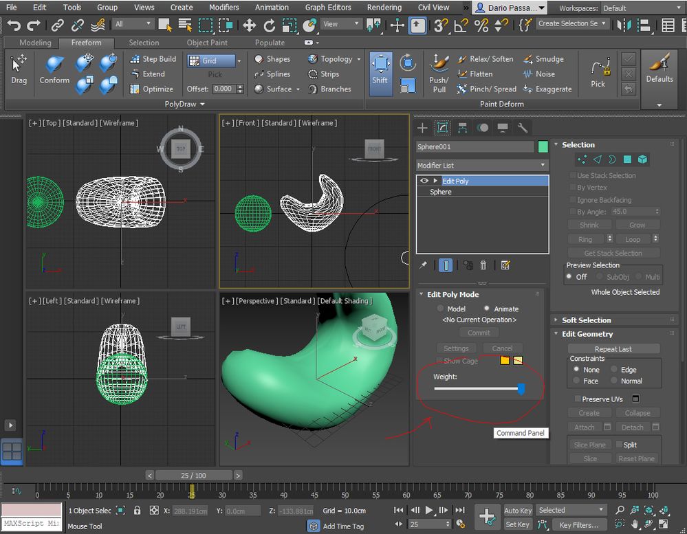

One my idea is to have a weight control in EditPoly to use like mudbox in animation!
... and to have a opportunity to register FreeForm deformation from ribbon tool (actually is not possible)
This control will be able to help users in SDK, wireparameter and in all part of modeling / animation

Hey @passariello How would this be different than just doing a morpher modifier?
passariello
becouse is impossible to use graphite or sculpting on morpher without a continuos go and back from diffetents modifiers..... my request is a simple implementing that open opportunities to have a unique are to work without tons of neurons to remember the use of a ****ing morpher, tons of copies of the same objects in memory.... sorry
