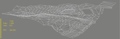

I want to create a collision meshes for Unreal Engine, if the object is a car or a wall then the process is easy just a simple box will do the job.
but what about a terrain? (in my case the player must be able to walk on it)
i'm not sure what is the good way to make a collision mesh for it. Smiley Frustrated
Here is an example of the terrain that a want to make a collision mesh for it (it is one of many):
Any suggestion or hints?
and here is the .max file (just in case).

From what I remember, you should be able to use a duplicate version of the same ground plane mesh as your collision object, yours doesn't look overly complicated, just export another copy! I haven't worked in UDK in almost 10 years, but here is some documentation on collision objects from the UDK site.

Hello Hagen, thank u:) the link is containing useful information.
And if someone interested I also used one of 3ds max modifiers called ProOptimizer it helped me to make the collision mesh with less polygon.
