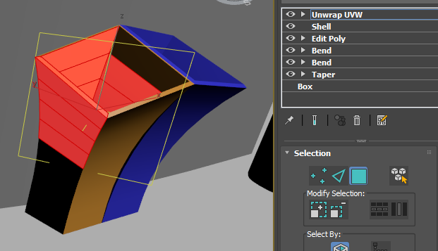

Thanks @Anonymous and @hagen.deloss for the answers.. Anyway i'm not good at explaining my problems, so here i attached a video for the problem i'm facing..  Anyway, the trashcan should've turn red after i click on it right?
It is a problem similar to the one I was pointing.
You have locked the selection in face subobject mode in the edit poly modifier that is below the unwrap. This limits the selection available for the unwrap modifier.
Simply uncheck the face button in the edit poly modifier to remove the face selection. Notice how the squared icon disappear in the right of the modifier stack top list.
Problem solved.. Thanks @Anonymous and @hagen.deloss
