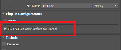

I can't seem to get textures to go along with my USDZ exports now. I've done this a dozen times in 3dsmax 2023 with the previous USDZ exporter, but with 2024 and the lastest USD plugin, I just can't get textures on my objects to save. I opened an older scene that has exported fine in the past and re-exported with the new setup and textures didn't show. Does anybody know what I'm doing wrong? I have an image attached of a setup that doesn't export properly. I brought the USDZ into Blender to test it too (thinking maybe it was just my phone being the issue) but Blender showed no texture on it too.

The export for the last few versions uses USD Shade NodeGraphs (https://openusd.org/dev/api/class_usd_shade_node_graph.html), so to comply with UsdShade connection rules. I dont think this is well supported in the iOS viewers - which unless I am mistaken, support the "arkit" spec. "arkit"  only supports a subset of USD features. When we export to USDZ, we do not comply with this subset of the USD spec.
Unreal similarly lacks support for USD NodeGraphs, and I had written a little chaser plugin for someone else to bypass the usage of NodeGraphs (see bellow).
After running this script, you will have the option to enable this chasers in the exporter UI like so :
What this chaser (a chaser is just some code that runs after the export to post-process the resulting usd stage) does is bypass the nodegraphs by connecting the materials directly onto the texture nodes. This violates some usd shade connection rules - but these are very rarely enforced and it might work for you (disclaimer : have only tried this for unreal, only suspect the issue is the same).
As I said though, the ARKIT USD spec is a small subset of what is supported in USD and so many other things may not work.

I'm not the best with scripting. I copy/pasted and saved as a .ms in the max script startup folder. When I manually ran it I got an error. How should I proceed?
Message 7 of 8
julien.deboise
It is a python script, not maxscript - you need to save it as a .py file instead so that 3dsmax knows to run it as Python before running it manually. I dont think startup scripts can be python - but you can do this : https://help.autodesk.com/view/MAXDEV/2023/ENU/?guid=MAXDEV_Python_using_pymxs_pymxs_differences_pym...

Thank you so much! It worked perfectly.
