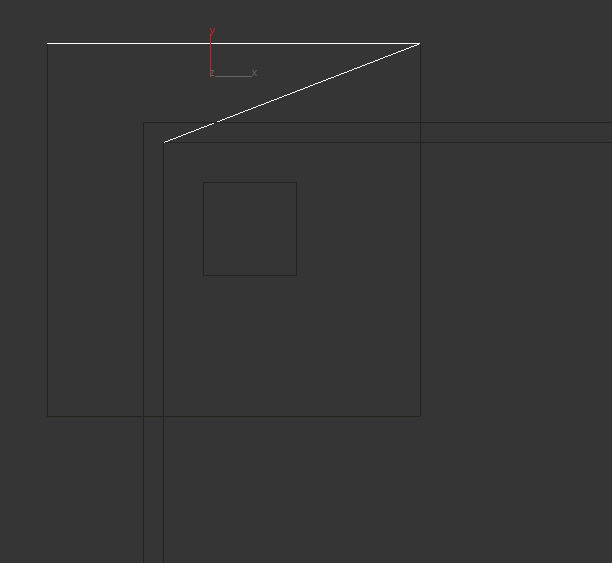

whitebirchstudios
Snap used to be constrained with the shift key, but in 2025, that doesn't work anymore, which is a nightmare.  In the image below how do I draw that second line straight down, snapping to that parallel line? Before, I would hold downshifts to accomplish it. Now, I have to snap to the end and go back and move the endpoint.
