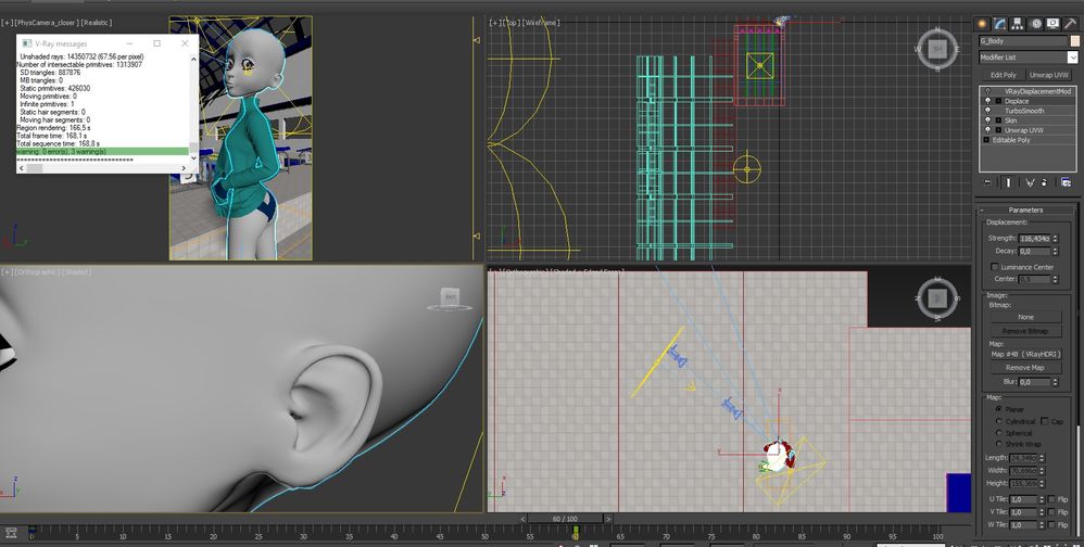

The skin issue is totally fixed. Though I can't make the vray displacement map work. I tried applying shift like you said, makin it (-amout/2), tried many diferent values too, but weird things keep happening to the mesh and I don't know what values to adjust to fix this.
Message 6 of 13
After posting this I realized that I should try  smaller values, the weird distortion seen on those photos I posted before has been fixed, however, there is still no displacement happening.
I tried using the values "amount" = 0,016 cm and "shift" = 0,08 cm. No distortion happening, however no displacements happening eather. After that I tried making the amount value a bit higher but without touching the "shift" values nothing seems to change, and if I do change the "shift" values the ear starts getting thinner and loosing shape. If I go too high of values for both "amount" and "shift" I starts happening the weird distortion again.
Is there some other thing that I am missing? Or am I doomed to keep on trying out random values until something works?
the 1st image is the best result I can get from the v-ray displacement mod. And the second image is what I got out of the regular displacement mod. (the ear there had weird jagged edges but I added another itineration on turbo smooth and that no longer happens)

Alfred.DeFlaminis
Hello @Anonymous,
I'm glad the skin crash issue is worked out, I'm going to mark the solution but keep helping you with the displacement issue in this thread.  I wonder, if I create a private folder for you, could I check out the files?  Did you create the displacement in Zbrush?  What bit depth is the displacement map?

Hello, thank you so much for your help.
I rendered the displacement maps in Zbrush, i'm not sure if this is the information you asked for but I think I rendered the image as a 32 bit EXR. file, with the mid value set at 0.
I managed to make the displacement map work a bit better using the displacement mod, it is still not perfect, but due to my lack of experience i'm starting to think my geometry maybe is not good enough to change this much simply by using displacement maps. The biggest issue seems to be the mouth that is supposed to be closed.
Still no progress using the vray displacement mod.
I managed to use Udims by applying into the modifiers a "composite" with the 2 bitmaps in it, instead of applying a bitmap or a Vray HDRI directly. (when I do apply a bitmap or a vray hdri directly the problems continue so i don't think this is the issue) I'm not sure if this is the best method but it was the only way I managed to find out how to use Udims.

Alfred.DeFlaminis
Hello @Anonymous!
Please don't be sorry, part of your subscription fee is paying my wages and to be honest, I work for you.  I like helping people and it's a nice job, so I have no complaints.  🙂
For the UDIM displacement you might need to check on the Chaosgroup forums, I'm rusty there.  I did however see what I think is the issue with your displacement map.  Normally a zbrush displacement map has 127 gray as the middle value.  Displacement maps can go in both directions, but since your base color is black yours actually shrinks the model and then grows outward.  No good.  Adjusting the displacement amount probably won't solve the issue because the map itself would need to get weirdly blown out to fix this, and then other problems can crop up.
You'll have to refer a bit to the Zbrush forums, but there should be a way to export your displacement with middle gray as the neutral tone instead of pitch black.  I am confident that this is the source of your problems (or at least the majority of them) and continuing on is too hard without an updated displacement map out of zbrush.  I have a google search here to show what it should look like (see the various screenshots where there is no height info, I.E. outside the uv shells).  A displacement map of 127 would likely do nothing and then black goes inward, white goes outward on the map.  This way you can get displacement going in both directions.  You're goes only in 1 direction, but first it pushes everything inward.  Am I making sense?

Indeed you are making sense. Thank you. And thankfully I already know how to export the displacement maps using the grey and not the black. I'll try exporting it correctly and applying it in the morning, and leave an update of the situation here.
Crazy, I had read in multiple places (random forum posts and such) that for the displacement map to be read correctly in 3ds max it had to be black, that's why I was doing it that way. :$ Its funny really...

Success! It took me some attempts to export the displacement maps correctly from zbrush. But I managed to do it and it worked. Thank you very much. No more problems here. 🙂
