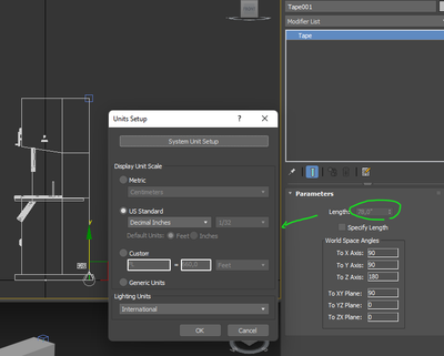

It seems you should set the Scale Factor setting in the above dialog to that of your current system scale.
Automatic does that to keep the imported file in the correct scale in your current System Unit Scale.
If you'd like to see the size of the object in another unit, then you need to change the display units. This is the correct approach. (Below: Display Unit set to Decimal Inches while System Unit is in centimeters)
Scale factor unit in the import dialog is to be set different from your system unit only if the incoming file has an incorrect scale. It doesn't modify your system unit, but forces the program to interpret as the value you've set.
Eg. My system unit is cm. If instead of cm, I set the Scale Factor to meter, which is that of the incoming file, then my object size of 1.98m will be interpreted as 1.98 (assuming my system scale were meter) but since it is actually cm then the object is scaled to 1.98 cm. (2cm)
If you prefer to work in some other system unit, then you should change the system unit first then import and set the scale factor as the new system unit value.
