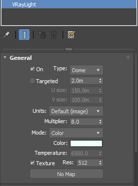

Thank you so much for your quick response!! Yes I am using Physical Camera and I am using Vray Sun and Vray Dome Light (I found some settings from a tutorial as I am not familiar with 3ds Max). Can you please recommend the best Vray settings for lighting? Please find also below my settings:
1. Dome Light out of the building:
2. Vray Sun:
Thank you once again!!
CAMedeck
Hi @Anonymous , in your first screen shot I can see that you are adjusting the exposure of the image in the V-Ray Frame Buffer.  I don't believe that changes there will carry over to the saved image, just how it is displayed in the viewport (it says 'Display Only' right by the setting).
Press the 8 key to bring up your Exposure settings, and adjust those to get the right level of correction for your scene.  An Exposure Value of 15 is good for an outdoor scene being lit with daylight, and lower numbers will brighten the look overall.  What works best depends on your scene lighting.

Thank you very much both of you!  It was a problem with the Exposure Value. Have a great day!
