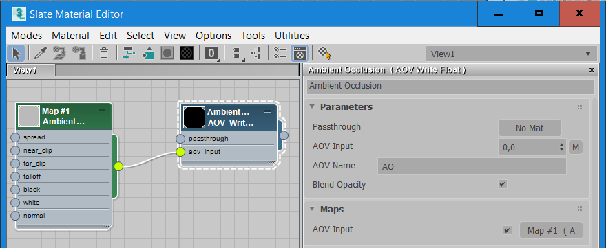

You can get a very simple AO pass in Arnold with no need to apply a material to all objects or using state set by using AOV that is the equivalent to render elements.  Try this:
1 - Create a material AOV Write Float, put AO or something in the AOV Name and plug an Ambient Occlusion shader in the input like the image below.
2 - On the render setup, go to the AOVs tab and add this AOV Write Float material to the AOV Shaders below. Then click in Add AOV File to create an AOV and then in the custom field you add the same AOV Name that you put in the shader.
3 - Then you can add this custom AOV and it will render an AO pass straight from you render like before.

"and plug an Ambient Occlusion shader in the input " - How exactly / where are you getting the node / shader on the left? I'm digging through all the nodes and can't find this.
Please assume we're all pretty new to Arnold, and some of us have no idea what an AOV is.

The Ambient Occlusion node is under Maps > Arnold > Surface

First, did you click the Add button to create the AOV?
Then you will only see it in the render window while using the Active Shade in this tab:
When use the Production Render you need to set a render output on the common tab and then Arnold will save the AOV in the same folder using the same name as a prefix.
In this example I'm using the default settings but with this procedure you don't apply the material to your objects, it will only show up in the AOV. If you want to apply the material you have to create a "map to material" and plug the Ambient occlusion map on it.
Hope you get it all clear now, we are all new to Arnold yet. Smiley Wink

For your method - I figured that part out by dragging the node out (I've basically never used the Slate Editor, only know how to shut it off) and choosing it, but kind of lost me in the 2nd and 3rd parts of your guide:
"Then click in Add AOV File to create an AOV and then in the custom field you add the same AOV Name that you put in the shader." - Specifically "now you put that in the shader". I've named and added my shader, but no idea how to put it in the 3rd blue-line slot you underlined in your screenshot or what to do exactly after I've made this. Never used an "AOV".
