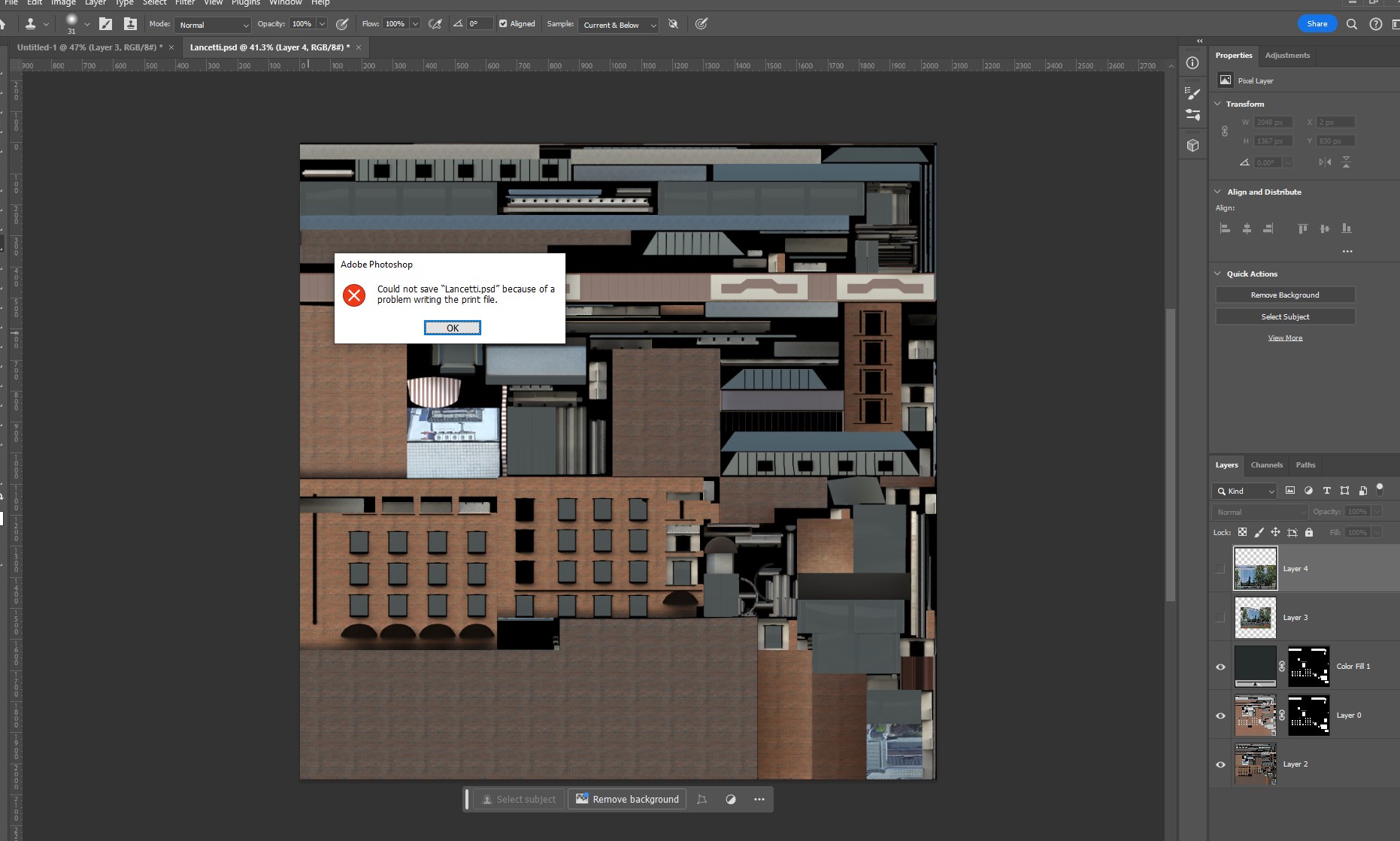

My first report of this problem was in 2016.
When I try to save a psd file used by a material assigned to an object (in 3dsmax 2025 and 2026) gives an error, specifically:
"Could not save file.psd because the file is already in use or was left open by another application".
With every release the problem pops up until at a certain point, usually after a yaer or so, and update fixes it.
Since it's a known bug, could you please resolve the issue definitively?
Just to be clear the install is fresh, nothing is changed. The issue has been present in EVERY release since.

It happens in windows10, windows11, with PS 25.9.0, on two different computers. Both pcs mount an Nvidia card.
I'm trying max2024 and the problem is even there(So, 3dsmax 2024,2025 and 2026). But the problem has almost always been there through the years and then resolved by the updates, regardless of different video cards, hardware and so on.
Anyway, here's the screenshot

giuseppetonello
Here it is.
Anyway I think everyone can replicate it with the following steps:
1. Create a box inside 3dsmax
2. Assign a material to the box
3. Assign a psd file to any slot of the material (say the diffuse)
4. Edit your psd in photoshop
5. Try to save it in PS. You will not succeed. The file is kept hostage of 3dsmax. Same story in max 2024, 2025 and 2026.

giuseppetonello
Hi haifeng. That doesn't work, nor unchecking autotile and automipmap nor flushing the cache.  Just to be sure, did you try to fix the error with that solution?

haifeng_yuSEVKN
Hello @giuseppetonello , you are correct, it seems like only 3ds Max blocks the PSD files but not other applications. I also tried the article I shared with you, and got the same result. Please allow me to do more research if I can find more information for you. Thank you!
Haifeng Yu
Technical Support Specialist
Message 11 of 12
haifeng_yuSEVKN
Hello @giuseppetonello ,I have logged this issue in our system and this way allows our development team for further invistigation. Please keep this number BSPR-110874 as your refererence. Due to Autodesk policies in regards to defect tickets, I cannot provide a timeline for when this ticket will be addressed or released into a future update or version of 3ds Max. However, you can check in the release notes when new versions are available to see if your defect ticket number was a fixed issue in that release. Thank you.
