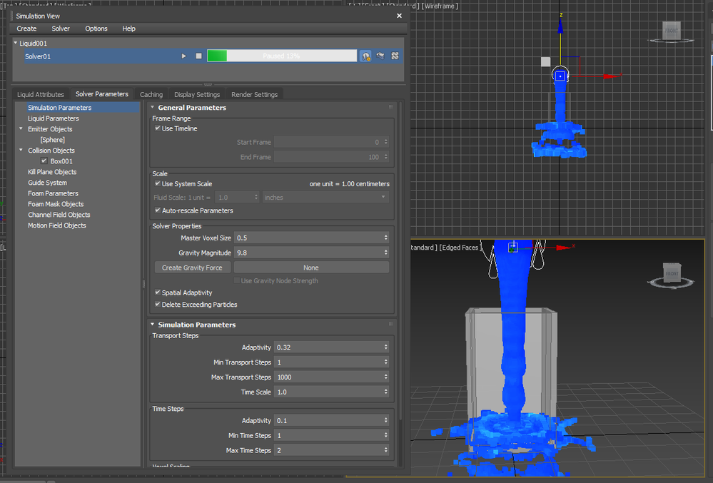

When I was simulation of fluids system, It's particles passing through an object.
Of course I did add colliders.
What can I do for correct outcome?

I'm not sure if this will help but I had the same problem lately. I solved it by scaling the scene. Have a look at my thread.

Thanks to answer!!!
but my scene's problem is big particle. maybe
Like this picture.
master voxel 0.1master voxel 0.1
master voxel 0.5master voxel 0.5
I add the collider of the same shape, but there was no big difference.
Sorry for not being good at English.

I'm by no means a particle expert. But, are your normals for the container pointing the correct direction? Not sure it makes a difference. Just thinking about things.
