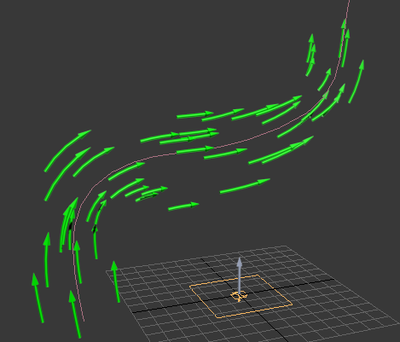

Im trying to use a particle system that uses my instanced geometry of a 3D arros to move along a path, but also deform along the shape of the path as it moves.
How can I do this?

Hi, apologies if this is kinda too late.
Here's a sample (assuming I understood the effect that you want):
Also attached is a max2014 file.
Galagast,
Thats awesome! I need to look at mesher and figure out what its doing. Do you know of a way to stop the arrows from stretching in length as they go around the corners, or is that just a byproduct of mesher?
