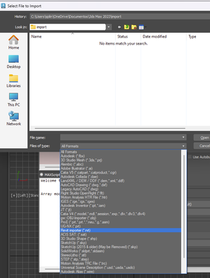

I have some older .drf files from a coworker and he asked me to open them up so he could share with the team. I thought 3ds Max was supposed to do this easily but the format doesn't seem readable. Is there something else I need to do to open, import, or view these .drf formatted files? I attached a screenshot showing the extensions I have as an option to open these with. At least, I thought this is what the help menu was saying to do in order to open them in 3ds Max. What could I be missing here?

You need to use the import option, but I don't see any .drf here
Which software was used to create these files?

Have you tried a drag and drop into 3ds Max?  I found the below text in the online Max 2023 Help.
"DRF is the file format for VIZ Render, a rendering tool formerly included with AutoCAD Architecture. The DRF file type is similar to MAX files from previous versions of Autodesk VIZ.
This file format is available only when you use the File menu
 Open command. All DRF files must be saved as MAX files in 3ds Max. Likewise, DRF files cannot be imported or merged into 3ds Max scenes.
Note: You can open DRF files using drag-and-drop functionality."
