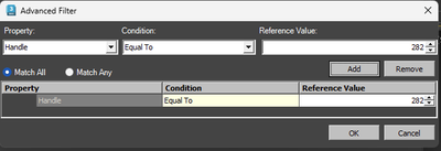

When using some plugins - Datasmith for example, when exporting your scene the status bar at the bottom left will show a % and a number like 18% 282/1562. is there a way to find out what has been assigned as the 282th object to be processed?
Do all Max items have a scene number assigned to them?
I'm having issues with exporting for Datasmith and this 282th object is crashing Max every time without warning and no error messages. It was working fine and suddenly it doesn't work at all.

wernienst
Here is something else you could try (success not guaranteed 😏 )
Open the Scene Explorer and select Display/Configure Advanced Filter. Select Property: Handle, Condition: Equal To, enter 282 as Reference Value. Click Add and then OK. Now a node with handle 282 is selected, if existing.
This is NOT the consecutive number!

theoG7GJE
I tried, unfortunately no results show up. Thanks for the suggestion though!
