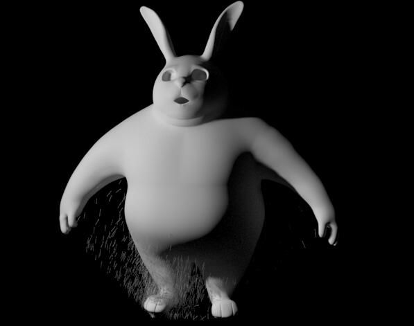

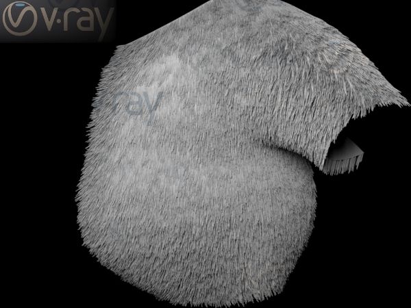

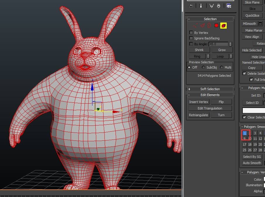

whats wrong with my mesh? I set all polygon's smoothing group to 1, but the face edge is still hard~it even affects my hair rendering, the hair based this mesh also looks very faced~no matter I use max hair or ornatrix or harfarm~result is the samep2.jpgp1.jpg

if I add editablepoly on the stack, smoothing group problem can be solved, but the fur rendering is still the same, I tried max hair, ornatrix and hairfarm, all the same~

first, in my pic I used vraylight, so it is supposed to look very smooth, specially the rabbit model is not that low poly~ plus, it also not suppose to affect the fur rendering, I can get very smooth fur surface rendering with even lower mesh~just this one ,very strange~

Hello @Anonymous,
On a closer look you are getting over 100,000 instances of "invalid normal index" errors when I render here.  So you're right that there is something wrong, but the faceted faces when using GI with an area light are normal.
I would do the following:
1) Reset the XForm on the bunny character.
2) Apply an Edit Normals modifier, select all the normals, then press Unify.  You have 4 normals for each vertex which is odd, this should fix that.
3) Collapse the stack
I think then the problem is solved for your fur.  Can you please try that for me?
EDIT: Unifying the normals might create some patchy normal smoothing in the fingers.  You'll have to manually adjust the normals to fix those using the edit normals modifier and a little time.  Chances are this was imported with strange settings, you might try to reimport to see why these normals are split like this.

it kills those hard edges on mesh, but still affects fur surface~no matter I use ornatrix or hairfarm, which means is nothing to do with fur plugins, still some normal problem remains I guess~1.jpg2.jpg

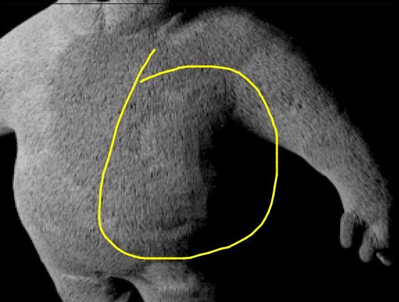

here is the result~quite obvious for those hard edges~I use a omni light and GI~
I attached the file with it~I use hairfarm for the fur and vray 3.4 for rendering~thanks for your help~

here is the result of max hair rendering, still faced`````gone crazy now~hahha

if I render the file you gave me directly, the result it like this~have I done anything wrong?e.jpg
Message 17 of 22
oops, I think I need to update topology in hairmesh brush. anyway, it seems a solution, and I acutally use the same way to solve the problem in ornatrix, it just need to add hair on a smoothed mesh~however I still feel very strange about this~ if you say it is because of the low poly of base mesh, how come it appears randomly, if I create a default sphere and add fur on it, there is no any hard edge no matter how low poly the shere is~
