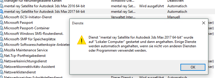

I can't start the mental ray DBR satellite service !
Can somebody confirm this?!?
In this case, the 2017 release is complete useless 😞

Hi! I didn't test it myself, as the german Version of the software is still not available...
But from your screenshot it looks like you have 2 instances of the MR-Sattelite service installed (one 2016 and one 2017)? And the 2016 seems to be running, you might need to deactivate it...

I tested it: It's the same error, while 2016 is deactivated...

Go to the windows services file and change the text from 2016 to 2017 [just before the port number] to allow launching the satelite service.  After doing this I now get an issue with can't find dll files when actually submitting a dbr for render on satelite machines.  But at least it renders locally.
Appears to be an issue now that the Nvidia files install in the plug ins folder instead of ..3ds max 2017/nvidia.
Message 12 of 46
Just wanted to add. The OP problem is that the "raysat service" starts then shuts down...even with 2017 eng version......I managed to resolve this issue by editing the [windows\sys32\drivers\etc\services] file. After 2017 install it directs the MR service to 2016......if you change the svc file to call 2017 you can start and run the satelitte service without it shutting down immediately......but.......when submitting a dbr render it still gives me an error of “cannot find dll's“ even if just rendering a cube with no materials applied.
Must be related to the new file path for the separate MR install. All the required files are still installed by the default path but they do seem to link to a “ray3rc“ file that doesn't install...changing the name of “rayrc“ file to "ray3rc" did not resolve the issue either. Apogies to developers reading this if my filee paths are off...don't have access to theactual errors now as my work netwotk is completey offline.
As other posts state....this seems like such an obvious error that I can't understand how it wasn't caught during testing for release of a completely new release of Max 2017.
Side note....my testing was on Win 7 SP1 (with all required updates) fresh install of windows 7 pro with no prior builds ever installed on any of the pc's.

Hi guys, after some fideling i got a working solution for the satellites to render when using DBR in Mental ray
Please follow the steps exactly and it should work ( at least it does for me )
  •  edit the file "C:\Windows\System32\drivers\etc\services" using a text editor
     change "mi-raysat_3dsmax2016_64 7523/tcp" to "mi-raysat_3dsmax2017_64 7526/tcp"
     note the different port (7526) number which seem to be the default port now
  • copy the rayrc file from the attached zip to your Max root folder: "rayrc"
    As you might have noticed, the raysat service exe's now sit in the Max root folder, hence you have to give them a rayrc with corrected paths to the MR shader dll's
  • run the following command in the mMaxscript listener ( otherwise the server would not find the dll )
    copyFile ( getdir #maxroot+"Plugins\NVIDIA\Bin\satellite\libmdl.dll" )  ( getdir #maxroot+"libmdl.dll" )
Please report wether this works for you or not

Works for me, thanks for the help Spacefrog:)

Yeah - seems that the 2017 MR installer simply has the "2016" instead of "2017" in that string  ("mi-raysat_3dsmax2016_64") by mistake. One thing i failed to mention in my post above is, that if you have had the real Max 2016 mental ray satellite entry in the services file already, you should copy paste the line instead of plain editing. And edit the COPIED line then as i describe above.
I can't remember 100% for sure, but i think the MR 2017 installation has simply overwritten the original 2016 line ,,,

I moved the patch to a seperate repository, here: https://github.com/jedie/3dsmax_patches
direct ZIP Download: https://github.com/jedie/3dsmax_patches/archive/master.zip
I also change the script, so that the service will start and set to "auto" at the end.
Now i tested my script and it works fine.
Apply the patch, looks like this:
