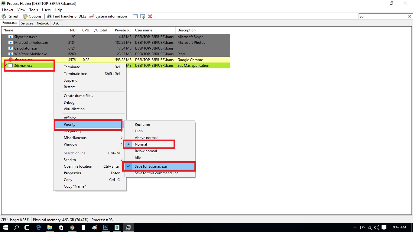

download and install:  ProcessHacker
1. Run this program as an administrator
2.: Open the program and go to 'Processes' tab. Locate the process you want to permanently set the priority of, right click it. Go to 'Priority' select the desired priority. Make sure to have the 'Save for [YourProgram].exe' ticked!
The process priority should now be set permanently. You can change it any time by repeating the steps above.

And I tryed the Process Hacker way but I can't find the checkbox " Save for "program" that you said. I looked for it in options, properties, etc, and I never found it.
