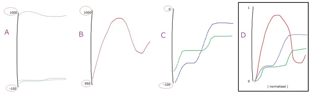

Maya "curve editor" offers  an option to visualize all selected curves with their values normalized(0 to 1). This way, the curves get visually condensed on the same area in the curve editor so it might be easier for some users to manipulate many curves and still keep seeing their shape ( see "D" below) . Specially useful for visually checking if keyframes or slopes are aligned.
In contrast, the green curve seen in the picture below ("A") looks almost flat at a distance, in case you want to see all curves at same time.  You need to choose which curve you want to adjust individually if you want to visually the shape of the curve better? ("B", "C" below). I am giving an example with only 3 curves, but you get the idea when you have to select multiple objects with similar animation but absolute values quite different from each other...

I believe the issue here is that the curve editor in 3ds Max expects to have single "Y axis", so it cannot show three curves with three different Y axis ranges...

Hello @brandaosa, thanks very much for providing the information. This is such a topic with a long history, but it's still interesting to look at. As @MartinBeh mentioned, 3ds Max cannot show three curves with three different Y axis ranges, and this is by design. However, some useful tools are available in the View section, including Zoom and Frame Horizontal and Value Extents, may also assist you in achieving a similar outcome. I hope the information could be beneficial to you, and good luck with your projects. Thank you!
