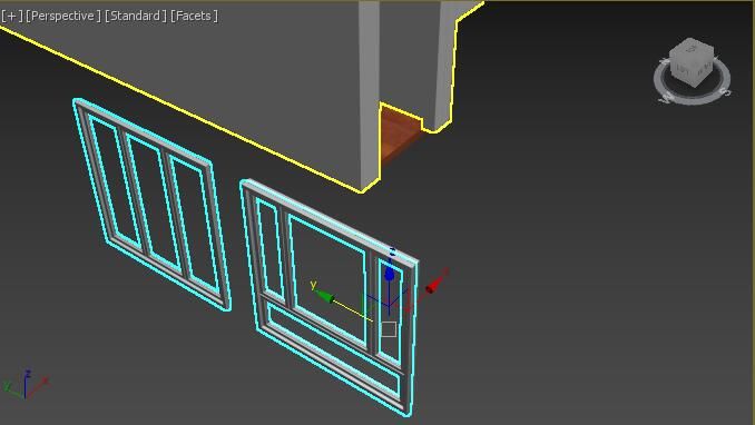

I downloaded the windows models and wanna merge them in my 3D project , ungroup is not working for it ? Any other suggestions?? THX
I just want the right one , but I ve ungrouped them and selected it , They still together ...THX

1. The model of 2 windows you have downloaded is a single mesh object (Editable Poly or Editable Mesh) and therefore all of it is highlighted when you select it as usual.    To remove the left window, you can go into Editable poly rollout, Polygon or Element sub-object mode and select the window you want to remove and then delete it or detach it (if you want to keep it as a separate object).

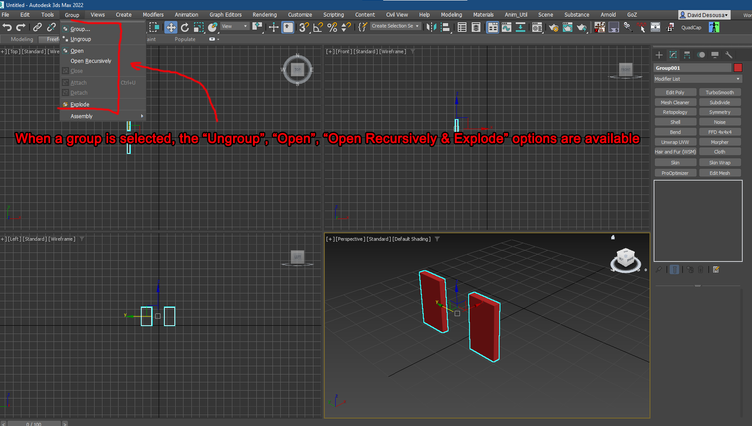

2. You actually have not completely ungrouped the windows model.  To check to see if this is the case look at the Group menu and if the options to Ungroup, Open, Open recursively are available and not greyed out, then you need to further ungroup.
If you are still having trouble post a screenshot of the model with the modifier stack visible.

Oh , THX , finally it's work with edit poly and detach them ... thank you~
