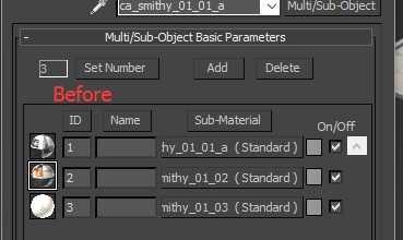

How to delete one of the sub-material by maxscript like the delete button on the multi/sub-object rollout。20170412114852.png
I used  deleteitem $.material.materiallist 2,but the result is  not what I want !

I tried but the result is different from the delete button. see below
Message 5 of 8
That is a good way.
Many thanks !

This should do the trick...
It's basically re-assigning materials before the delete.
	local id = 3 -- the matid to be deleted
	local mat = $.material
	with undo on (
		for i = id to mat.materialList.count - 1 do (
			mat.materialList[i] = mat.materialList [i+1]
		deleteItem mat.materialIDList id
