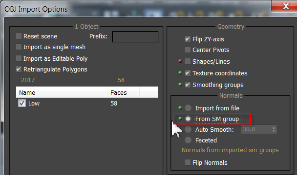

I see what you mean when I follow those steps, but it's not the smoothing groups that are incorrect but the normals which are getting Unified.  If you go check the smoothing groups on that imported model it's still working.  The workaround is easy enough, just use the File->Import and make the following change to your import settings, please.
Can you please try that for me?  Thanks!
Best Regards,

Thanks for all your work on this.
You are correct it is unifying the normals.
When I use the "Import from Smoothing group" option it fixes it for 2017. In 2016 I did not need to do this, Import from file has worked for years.
The issue is that not all programs have a "Smoothing Group" import option.
By that I mean, when I export and obj from 2016, and bring it back in , without the Smoothing group import, rather I use Import from file, it works fine.
And those OBJ's import into other programs without issue as well.
When I export the geo from 2017, and re-import it I must use from Smoothing group, when in previous versions I did not. Also OBJ's exported from 2017 imported into other software do not maintain normals.
So if I export an obj from 2016 and import it into 3dcoat for painting, the normals are maintained.
If I export an OBJ from 2017 and import it into 3dcoat for painting, the normals are unified.
Why change how normals were stored on export in 2017? It's obvious a change was made, as previous versions did not have this issue.
