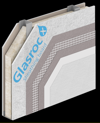

When I am converting 3dx max files to FBX , OBJ or glb materials are not exporting. Why? How i can solve the problem. Please help me
original image
Image in Blender no material. i imported in FBX format
Please help me. Is is same for OBJ and glb
Regards
Deepu

What kind of materials do you have there? both the type of material (Vray / physical / standard etc) and the maps - bitmaps or procedural or some complex shader network?
FBX can only export a small subset of those. usually the diffuse in standard and the basecolor in physical, maybe the normal map, not much else.
If your material setup is a PBR one with basecolor, roughness, metalness, normal, emissive and so, try using USD. be sure you have updated the USD exporter in the autodesk desktop app (or whatever it's called today). This'll import all of these maps. Small annoyance - to preserve appearance you'll need to change all of the color space values in every bitmap other than basecolor to non-colour. normal map is especially affected.
Oh, and it can also import splines, and it correctly exports object whose pivots are offset.
