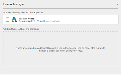

Change License Type to Student License
  1. At the top-right of the screen select the drop-down help drop down.pngtriangle  next to the User Name.
  2. Click “About (Product)” then click “Manage License...” to open the License Manager screen.
 3. The License Manager feature will allow you to:
  • “Change license type” to pull up the “Let’s Get Started” screen at launch to reselect (Sign In, Serial Number, Network Licensing)
  • > Drop Down to update your Serial Number & Activate
Please "Accept Solution" if a reply or replies have helped resolve the issue or answered your question, to help others in the community.
