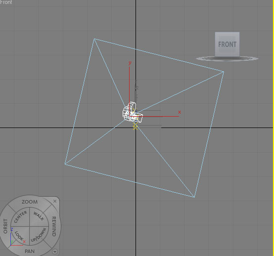

Hi! I have matched a camera to a background photo. I am trying to figure out how to get the information of the camera, degrees of rotation etc in relation to the groundplane.
Is there a way to get this kind of info?
Thanks for any help.

Hi! Sorry for being unclear. I use photomatch to match a photo since I already have a model of one objects in the picture. I then use campoints to match the CG object with the object in the photo. I have used this method earlier with 100 % sucess.
I am now in trouble since the object I am trying to match with the CG model is tilted to an unknown degree (in the photo). I have matched the object perfectly with photomatch but since the object is tilted in the photo, the camera is now in a wrong position.
What I want is to "reverse" the photomatch so that I can tilt the CG object as close as possible as the object was when the photo was shot.
The closest I can come is to select the camera and use the rectangle that surrounds it in the various views (front, right, top) to calculate the amount of tilting of the camera, but It would be a lot easier if the parameters of the camera were known since I lack the mathematical knowledge for this.
As the picture shows, the amount of tilting of the camera (in relation to the ground-plane) is showed by the rectangle surrounding the camera. I´d like to know if this information is available in text values instead of trying to calculate it myself?

I realise that the original camera position (as in the photo) would not be completely found this way, but I am still curious if the values of the 3Ds max camera is possible to get?
Message 7 of 8
eodeo
If you have the camera already and you just want to have its transform values (position and rotation) you can use transform type in dialog box by selecting camera and then pressing f12 while being in move or rotate mode.
In another words, select the camera, and then press f12.
"w" will chose move and thus show position of the camera.
"e" will chose rotate and thus show rotation of the camera.

Thank you! Thats what I needed, I never realised transformation values was available for cameras just as with objects! Problem Solved
