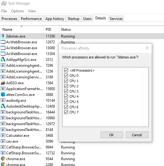

The 1070 is still a pretty decent card. I would like you to try one more test.
With 3ds Max running, open up the task manager and go to "Details" (assuming Windows 10), then right-click on the "3dsmax.exe" process and choose "Set affinity"
Try limiting 3ds Max to something like 8 CPUs and test again.

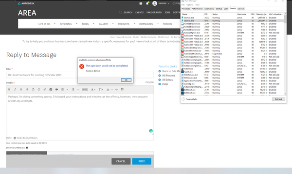

zancois
Perhaps I'm doing something wrong. I followed your instructions and tried to set the affinity, however, the computer rejects my attempts.
I am the owner of the computer. Not sure why I'm being rejected from setting it or clicking any of the right-click options. I only have 1 account I should be the admin.
