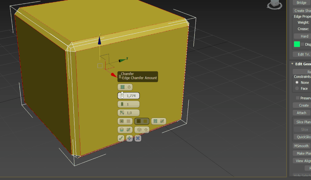

3) Using poly modeling tools like edge sect and then chamfer. Using the floating tool boxes to adjust spinner values. mouse curser becomes double arrow, vertically oriented, to drag spinner values. that's as it should be. Problem - since at least 2017 - after completion/exit form poly model tool, mouse curser now remains as double arrow instead of reverting back to single arrow/pointer. this is apparent whenever the cursor is moved over a dialog box or on the menu bar. Annoying as all get out.

3) Does not happen immediately with first edit, but sooner rather than later, after making enough sub poly edits using the little controls that pop up in the viewports to adjust spinners to change values for chamfer, bevel, extrude etc. At some point, after making enough edits, this will cause the mouse cursor to become a double arrow for the rest of the Max session. You must hover the cursor over the top menu bar or over the menu in a dialog box like the render dialog to see this. Very distracting and annoying. Have to re-start to make this go away. Also been happening since 2017 (the all time worst ever release). This cannot be happening only on my system.

3) I`ve used 2018 extensively for modeling, so i think i would have noticed something like this. Does it happen only with caddys or legacy dialogs too?

  3. Can you perhaps share a screenshot of this behavior, and details on how dense your mesh is when it happens?

3) I could share a screenshot and I will try. But, the meshes are the most simple standard primitives like a box. converted to editable poly. AND....when doing a screen grab the cursor does not appear in the screen captured image. I would have to paint it in or find an image of one and paste it in.

  3. It sounds like a video showing the behavior would be helpful, here is a gif of what chamfer/cursor looks like for me!chamfer_cursor.gif

3) your not understanding my previous explanation. In your video the cursor turns to a  vertically oriented with double ended arrows while you are scrubbing he adjustment spinners. What I am saying is that after completing the edit, closing out of the edit sub-object mode, return to top level. The when mo invoice he cursor over the top main menu bar or the top bar of the control panel, or mat editor, or render dialog top menu.....  THE CURSOR REMAINS AS THE DOUBLE ENDED ARROW FROMTHE PREVIUSLY COMPLETED SUB-OBJECT POLY EDIT. WHEN HOVERING OUT IN AN EMPTY SPACE IN THE CIEWPORT IT IS THE NORMAL AND. ORRECT SINGLE SELECTION STYLE CURSOR. BUT WHEN MOVED OVER A MENU IT IS THAT INCORRRWCT HOLD OVER FROM USING HE SPINNERS INTHE EDIT POLY SUB-OBJECT. HIS DOES NOT HAPPEN IF ONLY ONE EDIT IS MADE. IT HAPPENS AT SOME UNKOWN INTEREVAL AFTER HAVING MADE A NUMBER OF SPINNER ADJUSTMENTS, LIKE YOU SHOW IN YOU VIDEO.

3) further clarification. Your video shows two different style curves. On the “standard” single arrow pointer. He other is the double arrow that appears when you are scrubbing the spinner in the caddy. That cursor remains on effect after closing out of and deselecting the editable poly. It appears on that style when hovering over a menu bar, main menu or dialog box menu. You have to do several, how many is unknown, of the edited before this starts to happen. It does not happen if you only do one n class out he editing. Must do several or more spinner adjustments but sooner, rather than later it happens. Happens every tome I do any minimal amount of this type of basic poly model adjustment like you show in your video.
