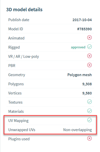

This 3D model is advertised as not having overlapping UVs:
Cartoon Boy at CG Trader
Using UV Mapper or another application I can see many overlapping polygons.
