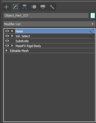

Thanks for sending me the scene! it was super helpful in figuring out *some of whats going on. I encountered the same crash as you in the scene you attached, so I loaded it up and narrowed it down to one object, Object_Part_537. So i saved out everything in the scene besides that object, and then merged it into a new scene. I haven't experienced any crashes in the new scene!
I did notice that the object was right before Object_Part_534....looks like there is 2 missing objects in that sequence. I'm not sure what script you used to create this mesh, I just wanted to point out that discrepancy, I'm sure there is a correlation between the missing numbers and selection issue.
I hope this helps with the issue! You may also need to re-simulate this if the issue persists. Let me know how you decide to proceed 😄

You figured it out! How did you get the modifier stack to show up before it crashed on you?

So on my machine, I tried to reproduce and see if I can get my own CER..it did indeed freeze like crazy (I was able to see the modifier stack)..however I left the app to go do other things while waiting to see if a CER window popped up..and when I got back to 3ds Max a few minutes later..it was unfrozen and now I can select/deselect it it as much as I want without freezing or crashing. Strange..

@Anonymous I was midway through deleting problematic objects before sending you the file, the missing parts of the object list were deleted by me as they were causing a crash, they definitely had the same modifier stack.
