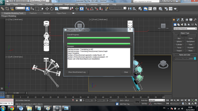

Max (3ds Max 2017 SP3) is refusing to import CATproducts.
File > Import > Select CATproduct > Open
Then the import settings dialog (that I usually see when I import cgr's) pops up.
Then... nothing.  It just blinks out immediately and my scene is empty.
It's been a while since I have imported CATproducts but I don't recall seeing the cgr import settings dialog.  Usually it's a bigger dialog box where you can see the progress.
But that dialog doesn't appear.  Just... nothing.
What am I doing wrong?
