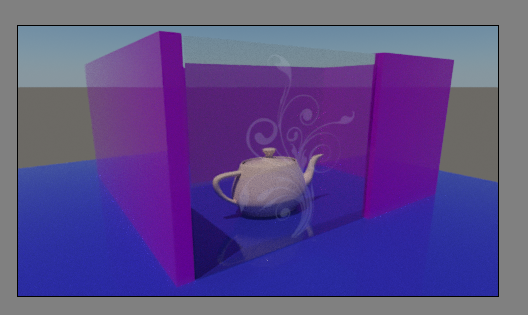

Yes, it works with the blend material ... Now I would like my stickers more white
It's too gray
Is it possible ?
thank you,
Alfred.DeFlaminis
Hello @sbellamy,
I need to be careful not to turn this thread into a how-to, but given that the original post had technical issues based on renderer I want to help here.  I think the best bet is a material setup like this one, and I've attached an example.
