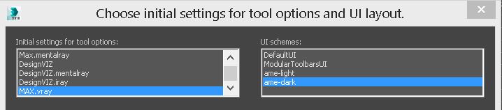

if you mostly use vray, you can set it a the default renderer:
go to Customize - Custom UI and Defaults Switcher
If you have Vray installed, you can choose MAX.vray initial settings / tool options.
I will investigate for the invalid assets instance error it seems that the path to the material lib is wrong, you are using 3dsmax 2016 right ?
