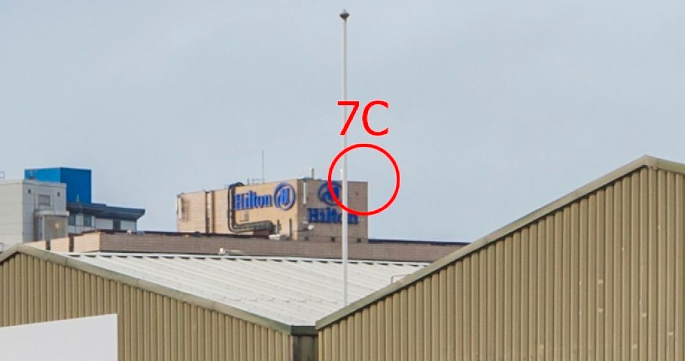

Hi everyone,
I'm new to 3DS Max workflow and I'm struggling with a model that I have to align to surveyed reference points in order to produce a verified photomontage in Max 2017.
The image will have an approximate field of view of 70-degrees. This will be made up of several individual images stitched together to make a panorama.
Question 1) Am I right in thinking that I will have to set up a camera and match its view to each frame/photo that will be needed to make the pano?
Question 2) I've set up a single camera at the exact location/elevation where I took my photographs. I'm trying to match that to a single photo and align reference points that have been surveyed that appear in the photo and that I have placed into my model (so that they appear in the camera viewport.
I am unsure how I move the reference points in order to get them correctly positioned over my photograph which is positioned on a plane.
The only way I can see is to move either the plane or the camera itself using the XYZ sliders. However I am certain I need to keep the plane perpendicular to the camera/target which limits any movement of the plane. I am then finding it very difficult to get all cross-hairs within 3DS Max over the corresponding points when keeping the plane perpendicular.
Am I missing something or is there a tool I don't know about that allows you to selects points and proportion a photograph to match them exactly?
Many thanks for your help,   Guy

1) The white cross-hairs were produced in Autocad by the surveyors as part of the data supplied after their site survey. They depict the reference points I proposed to them in the top panorama with the small circles. In the Autocad dwg, they're in 3D so possess X,Y and Z details for the exact locations (the X and Y being British National Grid 6-figure grid-references in metres and the Z being the height in metres AOD - Above Ordnance Datum). These were brought into 3DS Max within a single dwg that had the reference points and camera location plotted. Once in 3DSMax I rotated them through 90-degrees so they appeared as much as possible square-on to the camera in order that I could see them and hopefully align them to the corresponding feature in the photo
The two closest cross-hairs appear larger and intersect with each other which is a little confusing.
2) Perspective Match wasn't used here. As mentioned the white lines are a little confusing. It's more the centre/intersection of the cross-hairs that I'm using. It just seems that once brought into 3DS Max, the ones that are close to the camera appear larger and extend far more than required.
The idea is that my model (which is a proposed multi-storey building yet to be constructed and to be positioned behind the church tower) is accurately positioned within the 3D space, based upon the positions dictated by the architects plans. Once that is achieved I then need to produce a photomontage made up of 3-10 individual photographs stitched together into a 70  - 180degree panorama with the model correctly positioned within the centre of the panorama.
I hoped that if I plotted the surveyed reference points in 3DS Max, I could then move the photograph in relation to the 3D reference points and get them all to sit 'on top' of their correct position within the photograph. Once achieved this would be verifiable proof that the model is located accurately within the photograph in terms of both position and scale.
My problem how I see it is two-fold. Firstly, I need to align my model against the photograph points and secondly, because my final stitched pano is made up of several individual photos I believe I have to render out an equal number of camera views that match the individual photos (i.e. the camera/lens combo that took the photos has a HFoV of 39.6degree so I render out as many 39.6degree views as needed to make up my desired HFoV) - Is this correct?
Hope this help clarify what i'm trying to achieve Alfred.
Many thanks once again.

The top image shows my 120degree panorama set as the background. The image is 17850px by 5804px
I created cam points using the Keyboard Entry Rollout so that I could enter the exact XYZ positions supplied by our surveyors.
My first problem was that sometimes when I came to 'Camera Match' the small red crosses wouldn't appear when I clicked on the photo where the cam point should be. Sometimes the crosses would be there, other times they wouldn't.
My next problem is that because the background image is fitting to the viewport window (i.e. I can't seem to be able to zoom in on features within it), I don't think the cam points are where they should be. Is there any way to zoom in on the background (such as in the lower image), when you are positioning your cam points? If I could do this I could shrink the image size down, which I don't think is helping my cause.
Thank you once again for any help.

I see.  The red and green crosses just need to be close.  They are used to match the 2d image to the 3d points to map out the camera distortion or lens barreling.  I've never used it on a pano before and I suspect it may be because the image is on it's way to becoming a spherical pano that it is failing to compute the matrix. (I know it would confuse the perspective match tool.)  I wonder, would it be helpful if I were to create a private folder for you to put your file and background images in to do some testing?  I don't need your model/building, just the scene and the background images.  (NDA safe.)
I've done this with stills before but never a panoramic style image so it may be that it's too confusing for the camera match.  I'm in experimental territory with the stitched images, I've not used this process before.  I wonder if @dbhinnant has any suggestions on this process with the pre-stitched images for the bg.
If it was a full 360 pano it could be converted to a cross or something along those lines but with a partial pano it's a tough scenario.  That's why I was thinking doing a match to each image early on.  I think what I might try is to only use the part of the background that the render will appear in, which should minimize the spherical distortion and then comp the render into the 180 pano image at the end.  Again, I'm a bit outside of what I have done in the past so I'm mostly talking theoretical.
I supposed that another approach would be to work on the unstitched single background image, get the render into it and comped, and then use that with the other images to create your pano at the end.  This would allow you to work on a mostly flat background but still give you the end result you are looking for.  (Am I making sense?)

The best advice I can give is to forget about getting it perfect.  That's not going to happen.  Especially with panoramas.  Attached is a two image pano showing the cam points.  As you can see they are not perfect but are all pretty close.  The one on the far right is off quite a bit but you have to make compromises.
The most important thing is to have points distributed throughout the image.  When I get that error I try to use different points.  Start out with only 5.  4 that define the four corners of the ground plane and one that defines height.  If those points don't work, you can substitute points one at a time until you can create a camera.  Once you create a camera you can select it and modify the match by moving or adding points.
I only use the 2D pan and zoom to check a match as it's often hard to tell if things in the distance are lined up.
