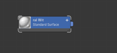

Hi all, this is probably a pretty easy question, but i cant find the awnser here nor online.
I have made a toon shader with my preffered settings.
added a ramp in front, toon in the middle and converted it to a material.
I have also made a material with the desired coloration and settings.
But now the problem, how do i connect the two? So that my 'combined' material has the outline of toonshader and coloration of my material?
I have experimented a bit by myself a while ago, and made a multi/sub-object, but it felt as if it did not really do justice to the colors i designed.
So, does anyone know if it is supposed to be done another way, or did i mess up with my first attempt within the multi/sub object?
Thanks already!
-NM

You can use "Blend" or "Mix Shader" materials, but I would recommend to render twice and do the combine in a compositing software.

MartinBeh
Good question! How should one switch materials for multiple render passes?
There a multiple ways to do this, and which one is the best depends on what renderer you use, how often you need to do it, and for how many objects and scene files.
Here are some ideas, roughly ordered in increasing complexity:
  1. Obviously, you could just have a selection set of all the scene objects that you want to change and then use that to select them and manually assign the material you want before you hit render. This is easy to set up but could be tedious and error-prone if you have many files, need to do it often etc.
  2. A slightly better way would be to have a little shader tree where the last material is a "Shell" material that allows you to decide which of two materials is shown in viewport and renderer. There are other materials in 3ds Max that can do something similar, e.g. the Blend and Mix at zero or 100 percent
  3. More than two materials offers the  "Material Switcher" and gets assigned to all your objects. This allows you to easily switch between multiple materials.
  4. Or you could get started using State Sets - these allow you to record (and replay) a certain scene configuration in combination with multiple render passes but a bit complex to set up (and might not always work reliably).
  5. And older, somewhat simpler, variant of State Sets still present in 3ds Max are Scene States. These can then be used in combination with Batch Render, for example

MartinBeh
@n_maasdijk  schrieb:
But can you explain a bit more what you mean by setting a 'shell material' or 'selection set', and how would you implement this? Does that mean already linking it to objects within the slate editor, or is that not possible (it does not seem to work with me)?
  1. Create a new Shell material and assign it to all your objects that need material switching between renderings
  2. Insert the two materials you already have into the input slots of the Shell material
  3. Use the Shell material 'Render' parameter to switch between the first and second material (here named 'original' and 'baked'), then render.
Note that Shell was originally designed for texture baking but it should also be fit for this purpose.

n_maasdijk
Both the shell function and GIMP sortware work wonderfully freund.
