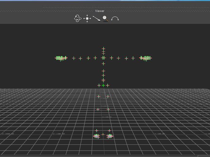

However, I must ask you another question, when I am using my original file ***Basic_Female_Avatar*** attached to this post... I can see the skeleton in MOBU so I can easily characterize it, however if I open same file in 3ds Max and export it back to .fbx and re-open in MOBU, all the bones are missing, I can only see the effectors (like on attached screenshot).
Would you able to point me out what am I missing while exporting from max?
edit: I checked "Convert deforming dummies to Bones" which gave me some sort of skeleton in MOBU but it's not rigged like original file and I feel it's not the right solution.
