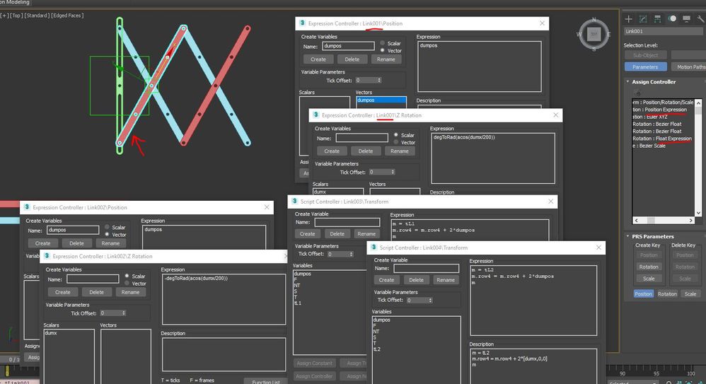

I have a simple scissor rig that works using using bones and helpers on a path constraint from this link on the forum.
Problem is that this only slides one of the scissor legs at the base. How do I go about sliding both legs away from the midpoint at the base of the stack (see picture below)?
I've tried several bone and IK configurations but can't get it to collapse properly. It has similarities to the recent scissor gate tutorial from @leeminardi but much less complex. Incrementing the stack like in the tutorial is super handy for when you need to add more height to the scissors.
How would I go about adapting these types of scissor rigs to what I'm after?

I took a different approach for your scissor mechanism.  Rather than using an IK solver, a single simple trig statement is used to control the angle of the scissor links.
I created a dummy named DummyControl.  It's X position relative to the Base Dummy is used to define the extension of the mechanism. It has locks on its Y and Z position so it can only move in the x direction relative to DummyBase. Link001 (red link) has a Expression Controller for its position and another one for its rotation about the z axis.  The rotation of Link001 is simply  = acos((distance of dummy control from base) / 200) where 200 is the length from the end of the link to the center.
Additional links can be created by cloning links 3 and 4 then editing the multiple of dumpos.
Let me know if you have any questions.  I gotta run.

jasond240
Hi Lee,
Very interesting approach! At what rotation of the links do you assign the rotation expression controller? When I try to re-create your example, the links do not retain their initial rotation when you evaluate the expression. This disconnects them from the other links/base.
Also, how would I add a dummy at the top of the stack to link the scissor platform to? I thought of an attachment constraint to the top of the right-most side of the link in the example but that doesn't seem particularly appropriate here.
Many thanks!
JD

JD,
Here are a few tips and suggestions.
  1. I started with two links in a horizontal orientation made from an outline that was extruded. The red link has its pivot on the bottom while the blue link has its pivot on top
  2. Things are much easier if a principal axis is in the direction of the link. For me the  local x axis of the links point in the long direction of the link.  I think you started with lines with a renderable thickness with badly oriented pivots.
  3. I link everything to a base dummy so that the final mechanism can be positioned and rotate anywhere in 3D.
  4. To answer your question, it doesn’t matter “at what rotation of the link “ you assign the expression controller. I assigned the position expression controller first to Link001. After clicking evaluate it should be centered on DummyControl. If it is not make sure it is also linked to DummyBase. I then created an expression controller (Float Expression) for the Z rotation of Link001.
  5. “…how would I add a dummy at the top of the stack to link the scissor platform to?” I would add an expression controller to the “platform” dummy that uses the position of DummyControl relative to DummyBase. For example, Let’s assume there are three “X’s” to the mechanism, the position of DummyPlatform is 6 times the distance from DummyBase to DummyControl.
  6. Note you have a decision here whether you want to work with a distance (a scalar) or a vector. If we decide to use a scalar distance for positioning DummyPlatform then we could use a Float Expression controller for its X position. Since DummyPlatfrom is linked to DummyBase its X the position value we get in the expression controller is already relative to DummyBase and the expression for the X position of DummyPlatform is:
       6 * dControl
    where dControl ha been assigned the x value of DummyControl.
    Using a scalar to position DummyPlatform does not address the need to also address its Y and Z coordinates. You could manually adjust the Y and Z values and then lock them (via Hierarchy, Link Info).
  7. Instead of using a scalar distance you could use a vector. Here you would assign a Position Expression to the Position   of DummyPlatform. The expression would be the same but the result is a vector since the variable dControl has been defined as a vector (the 3D location of DummyControl relative to DummyBase).  No need to worry about the Y and Z coordinates if they are controlled by DummyControl.scis3.JPG
I hope this explanation isn't too long winded but I think there is a certain beauty with how Max let's you control object position and rotation and I'm glad to share what I have learned.
Let mw know if you have any more questions.
Lee

jasond240
I ended up using a vector to place the top dummy, don't know why I didn't think of that since its so similar to when you add another pair of links to the scissors.
Here's the kicker,
  1. Things are much easier if a principal axis is in the direction of the link. For me the  local x axis of the links point in the long direction of the link.  I think you started with lines with a renderable thickness with badly oriented pivots.
We are working from engineering models where the scissors are already in a fully elevated position. This means that we cannot rotate the links to a horizontal orientation prior to setting up the expression controller as you've done in your example. If we did, it would become very difficult to realign the stack with all the pins, etc. as the rotation is essentially arbitrary. The example I posted was just a quick mock-up. I tried rotating DummyControl to match the initial link rotation but this did not work. I think we need something similar to orientation constraints 'keep initial offset'.
Thanks so much!

leeminardi
I think you can just orient the pivot of the links so that a principal local axis points in the direction of the link then use the approach I outlined.
I sometimes found it difficult with Max functions to orient an object's pivot the way I wanted so last year I wrote a Maxscript to help me.  I just modified it to work with two user specified points which I think would be helpful.  Just select one of your links and  execute the script  and follow the prompts to identify two points.  The script will reorient the local Z axis of the object so that it points in the direction of the two points.  Use snaps to access the reference points of the link.
After using the script you can use the z axis (rather than the x axis I used for the scissor) or rotate the pivot by 90° about Y to have the X axis point in the direction of the link.
