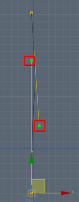

mark_aldred
Thanks. I've tried SplineIK, but I can't seem to get the right balance of bones/dummies to maintain the straight portion at either end. I've attached a screenshot of the shape I need to get.

RGhost77
You just need proper position of bezier handles, I think...

mark_aldred
Weird. I just cannot seem to get it to work. How many bones and helpers are you using?
I've attached my attempts with two and three points. max 2020

RGhost77
You asked "easiest way" so no need to use bones...
Please check my scene.

mark_aldred
Thanks. I'm on max 2020 unfortunately. Could you export it to that please?
Message 8 of 9
RGhost77
Sure

mark_aldred
Outstanding!
Apologies for misunderstanding your original post.
Thank you for the help!!
