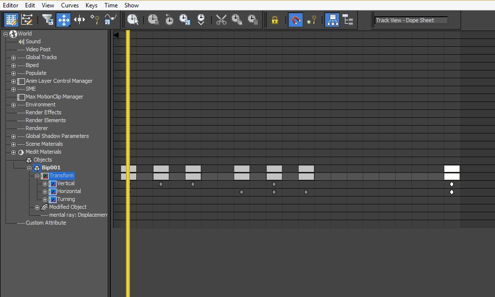

In all the rest bones of the biped, I can see the curves in the curve editor.
However, while animating the root ( Bip001 ), I can only see the keys in the DopeSheet graph editor, but not in the curve editor.
How do I fix that?
Curve editor:
DopeSheet editor:
Edit: I see now I can see only the rotation curves if i'm selecting the "Turning" in the hierarchy:
But there is still nothing if I'm selecting the "Horizontal" and "Vertical".

Ok I see now biped bones have their own curve editor.
