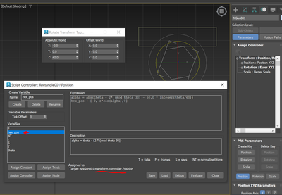

Here's anther solution this should be very precise and accurate.  In the attached file is used a position script for the rectangle.  The expression relating the vertical (y) position of the rectangle  to the rotation angle (theta) of the hexagon took a little thought.  When using Euler rotation controllers it is possible to get angles > 360°. In addition, allowance has to be made that every 60° of rotation the rectangle comes in contact with another surface.  The expression I came up with is:
alpha = abs(theta - 2* (mod theta 30) - 60.0 * integer(theta/60))
hex_pos + [ 0, r*cos(alpha),0]
Alpha is the angle used by the cosine function to determine the Y coordinate of the rectangle.  The mod function is used to get the remainder of the angle for every 60°.   Converting theta/60 to an integer provides a multiplier for every additional 60° of rotation.
I think it works very well!

Here's a clean, accurate, and precise solution for any line that defines a convex hull shape.
I wrote it to work on the XY plane and place the rectangles pivot above the rotating shape's pivot.
The rectangle has the following position script where LineShape is referencing the line object.
ymax = (getKnotPoint LineShape 1 1).y
for i = 2 to NumKnots LineShape Do
  vert = getKnotPoint LineShape 1 i
  if (vert.y > ymax) then ymax = vert.y
[LineShape.controller.position.x, ymax,0]
